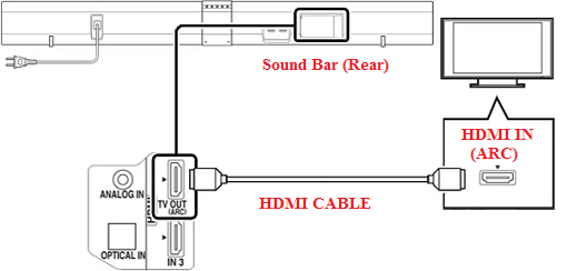

  • If the TV has an ARC ( Audio Return Channel ) label on one of its HDMI port, connect the HDMI® cable to the HDMI ARC port on the TV and the HDMI OUT (ARC) on the home theatre system or home audio system.

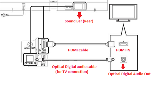

  • If the TV has no ARC label on its HDMI ports, connect the HDMI cable to any HDMI ports on the TV and to the HDMI OUT (ARC) on the home theatre system or home audio system. Then connect an optical cable to the optical output port of the TV and the DIGITAL IN (TV) port on the home theatre system or home audio system.
NOTE: If you cannot connect the TV and the home theatre system or home audio system using an optical digital cable, use an audio cable instead.
